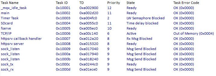

MQX Task Summary when _task_set_error() breakpoint hit (No TCP/IP error until after _task_set_error() returned):

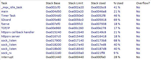

MQX Stack Usage Report (Notice no overflows):
MQX Memory Pools report (tons of available memory right?):

     Looking at the above stack usage screen capture it looks like the stack size for the TCP/IP task isn't the problem with only 17% utilization. It looks like the RTCS task was trying to allocate a memory chunk (400 to 500 bytes if I remember correctly) and was unable to do so. Examining the MQX/Memory Pools and MQX/Memory blocks info provided by CodeWarrior indicated there was aprox 130MB of RAM available to the system, yet the call to _mem_alloc_zero() failed and _task_set_error() (where I had a breakpoint set) was called to document that error. It seems to me that with around 130MB of RAM available to MQX that _mem_alloc_zero() should have been able to allocate a few hundred bytes?
     I'm trying to figure out where to look to determine how _mem_alloc_zero() could've been unable to provide the requested memory. Perhaps this problem wasn't the "cause" of the crash but just a symptom of some other problem? The MQX project seems to be completely stable until the web server is called into action, then it's only a matter of time before I run into this crash. Maybe it's an issue with porting the RTCS from 4.0.2 into MQX 3.8.1.1? Any thoughts on further troubleshooting? Thanks!

     I was able to observe a crash where the debugger continued to function and was able to view Task Summary and Stack Usage info. Looks like I have two tasks in distress (main and TCP/IP) with no stack overflows. I've tried increasing the stack size in both the RTCS init (_RTCSTASK_stacksize = 100000;) and HttpdServer init ( params.script_stack = 100000; ) but it seems to make no difference. A buffer overflow or a failure to release allocated memory would be my usual suspects, but that doesn't seem to be the case here.
~Tim
TASK SUMMARY
STACK USAGE

Luis_Garabo
Hi Tim,
Try to add a break point in the function _task_set_error(). Then take a screenshot to the task stack and share here so we can see where in the code these invalid pointers are coming up. Maybe we can figure out how to solve that.
