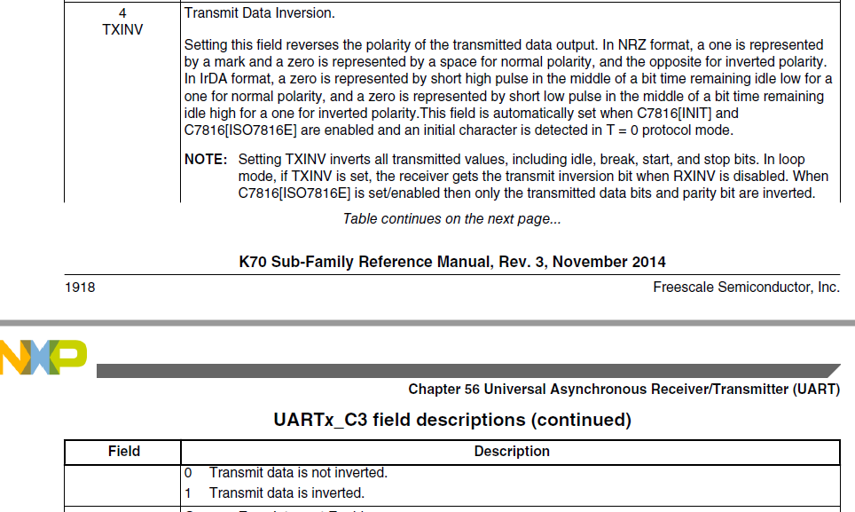

Hi Jesper:
Please check the UARTx_S2 register, there is one bit to control the Receive data Inversion.
4,624 Views
jesperevertsson
Hi Daniel, the RXINV bit is already set to 0. Also they way I understand is that the RXINV bit only inverts the data that is coming in from an external source. But as I said in my first post, there should be no data coming in on the rx pin. I also checked the LOOPS bit in the UARTx_C1 register but it is 0 as well.
4,624 Views
danielchen
Hi Jesper:
Please also check the TXINV bit in UARTx_C3
4,625 Views
