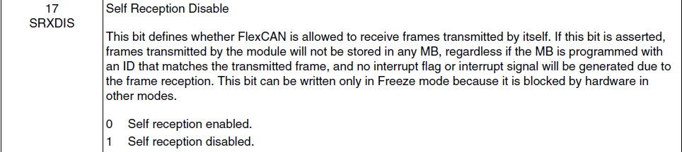

Is there any setting to prevent that ?
Controller should be able to distinguish between messages by other modules and by it self ....

Hi robroz
Please check the SRXDIS (bit17) in CANx_MCR register. This bit defines whether FlexCAN is allowed to receive rames transmitted by itself.

Thanks, great pointer to check....
