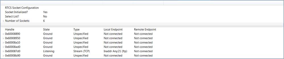

Hi everyone,
I'm using CW 10.2, MQX 3.8.1 and a custom board with MK60DN512
Here is a sample test task:
error = RTCS_create();
if( error != RTCS_OK )
     printf( "\nRTCS failed to initialize, error = %X", error );
     return;
while( 1 )
     FTPd_init( "FTP server", PRIO_FTPSRV, STACK_FTPSRV );
     _time_delay_ticks( 500 );
     FTPd_stop();
If I run this test, after some times the FTP cycle is executed I can see the socket number grow up (like in the picture):
The FTPd_init function creates an FTP server task that creates two sockets (the socket in listening state and the socket in ground state).
The FTPd_stop function destroys the task FTP server task, but it seems to close only the socket in listening state and not the socket in ground state.
Is this a bug or don't I make the correct steps to close both sockets?
Many thanks

The owner of the socket is "System".
If I break in my test before the FTPd_stop is called, there are two sockets in the list:
  • the one returned by the socket function at line 129 in ftpd.c
  • the one that will be returned by the accept function at line 177 in ftpd.c when the accept function will exit (the task is blocked inside the accept function waiting for an incoming connection, but the data structure is already allocated).
If I break in my test after the FTPd_stop is called, there is only the second socket in the list, and it remains there for at least half an hour.

The two sockets (the one in listening state and the one in the ground state) are both related the command port. The sockets related to the data port are created only when the connection with the command port is established.
The socket in the listening state is the one created with the socket function, while the socket in the ground state is the one created with the accept function.
No connection is established, so the program is blocked inside the accept function, waiting for an incoming connection. The accept function have not returned, but the socket have already been created (i.e., the socket data structure have already been allocated).
When the FTPd_stop function is called, the FTPd_Exit_handler is called and the shutdown of the socket in the listening state is performed (the socket data structure is deallocated), but the shutdown of the socket in the ground state is not performed (and the socket data structure is not deallocated): I suppose that the problem is that because of the accept function have not returned, the socket value of the socket in the ground state is still unkwnown at the higher level, so no shutdown can be performed.
