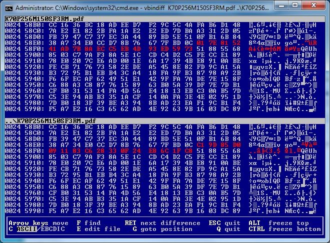

DamonGibson
Hello Carlos,
Thanks for responding.
I have tried several different file types.  My 162 MByte file is just a binary log file created by one of our products.  This week I have been testing with the K70 Reference Manual (K70P256M150SF3RM.pdf), which is 17,846,531 bytes long and I'm seeing the same problem.
Yes, I can open the K70P256M150SF3RM.pdf in Windows after retrieving it.
On the large binary file (162 MB), the errors happen every time, but the number of errors and their locations are different each time.  On the smaller .pdf file (17 MB), I successfully retrieved the file once without error, but found at least one bad 16-byte block in all other tries.
I initially just used the Windows Command Prompt fc command to compare.  Then I started using VBinDiff, so I could see what the errors were.
The VBinDiff screenshot below shows the FTP transferred file in the top pane and the original file in the bottom pane.  The bytes that are in error are highlighted in red.  For this FTP, the highlighted 16-byte block were the only errors.  All other bytes matched.

DamonGibson
Hello Carlos,
Thanks for the tip regarding tftp32.  Using the 17 MB Freescale K70P256M150SF3RM.pdf file, I did 10 FTP and 10 TFTP file transfers from the K70 Tower's Micro SD card to my PC.
For both FTP and TFTP, 3 of the 10 transfers succeeded without error, but 7 of 10 transfers failed.  The TFTP transfer failure mode was identical to the FTP transfers, in that one or more 16-byte blocks in the received file contained incorrect data (as shown in the example VBinDiff screenshot I posted before).
So, the problem does not appear to be in the FTP Server, which leaves RTCS, MFS or the SDCARD driver as the probable culprit.
