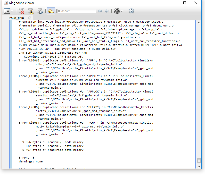

Also, I would like to ask that this development board supports the compilation and download of MATLAB/SIMULINK. However, after I set up his PDF document, there was a problem when compiling and downloading his own model.
I don't know whether it's his own model problem or my setup problem.How should this be solved?(And,I use  MATLAB2014a/b)

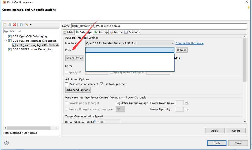

Then the following errors occur when the development board is subinstalled in the real program.

Hi Gududexue:
From your picture, you are using KDS ide.
I would suggest you select USB Multilink interface and try it again.
I also suggest you use MCUXpresso IDE if possible, since MCUXpresso IDE replaced KDS now.
