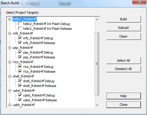

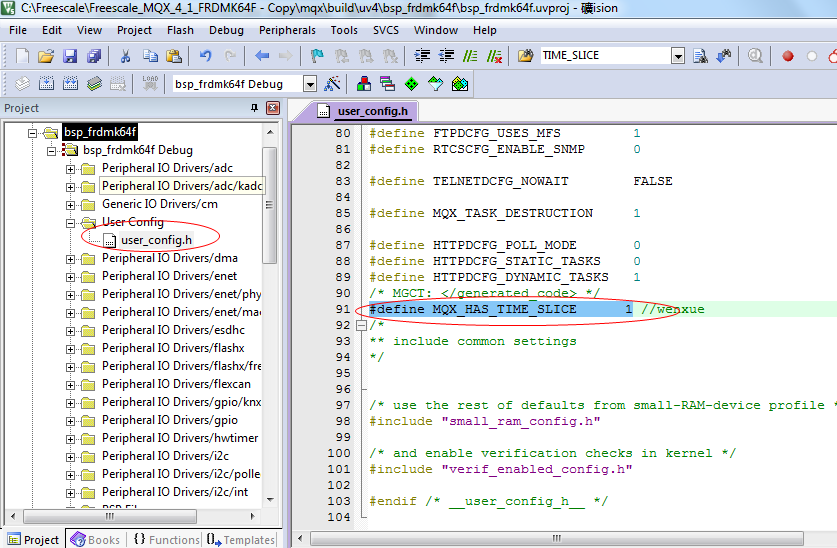

wenxue
I meet the same question with you. Now I have addressed it. The step is:
1)  open   <mqx_install_dir>/build/<board>/uv4/build_libs.uvmpw
1)  add    #define MQX_HAS_TIME_SLICE      1    in user_config.h
2)  Bebuild the MQX libraries(Please note that: you should Batch build)
3) Rebuild your application.
