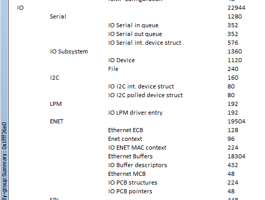

Andrey
I'm kind of running low on available RAM on my K70 project and when poking around found Ethernet Buffers occupying an 18k chunk. I'm having trouble finding where that gets set. Any help is appreciated?
1,919 Views
EAI
The number of RX and TX buffers for the driver are controlled by BSPCFG_RX_RING_LEN and BSPCFG_TX_RING_LEN. You can lower these by overriding the default values. FOr example, add :
#define BSPCFG_RX_RING_LEN 3
#define BSPCFG_TX_RING_LEN 3
to user_config.h and rebuild your BSP.
1,919 Views
Andrey
Changed it from 8 to 2 and that brought it down to 6k!
