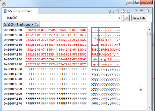

DavidS
Hi Sudhakar,
I think you are heading in the right direction but...
Why are you trying to write to the Flash IFR Register?
Once you issue the FlashProgram(); operation you should be able to read the Flash memory directly and not have to use a Flash Driver function call.
In the flash example code once I step over the following call (
result = FlashProgram(&flashSSDConfig, destAdrss, BUFFER_SIZE_BYTE, \
                                   buffer, g_FlashLaunchCommand);
), I can see the Memory window contents change from all F's to the programmed values shown below.
Please note that KDS/KSDK updates have been posted and I'm now using it.
Reference: New Kinetis Design Studio V3.0.0 available
David

sudhakarp
Contributor V
Hi David,
          i got it. Thank you very much. i used following step
unsigned char *dst;
dst=0xFA000;
     printf("\n\rDATA start\n\r");
            for (i = 0; i < BUFFER_SIZE_BYTE; i++)
                 FlashValueAtFA00 =  *dst;
                 printf("%d",FlashValueAtFA00);
                 dst++;
             printf("\n\rDATA END\n\r");
regards,
sudhakar p
