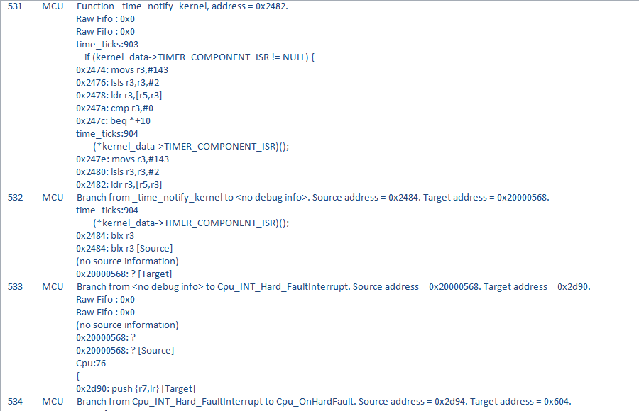

I did advance on this... I activated the trace (learning to use CW 10.3) and saw the following...
So my problem seems to see a bad initialized pointer (*kernel_data->TIMER_COMPONENT_ISR)(); That has on itself Target address = 0x20000568 pointing deep in the weeds...
I never mingle with that pointer since to me it appears to be an internal MQX Lite pointer I that don't know how to change (If I knew how to change it I could fix it, but then again I'm learning how to use MQX Lite and CW), so if that pointer is the problem then a MQX Lite configuration setting is messed up, please help me out to figure out which one...
Carlos

c0170
Senior Contributor III
Hello Carlos Rodriguez,
how is your timer component set? What timer do you use? It might be helpful to share your project (if possible at least small portion of it with that timer component active), or share more details.
Without any deep details, just step through init phase and check where is timer isr pointer set. Why is an address 0x20000568 assigned to it?
