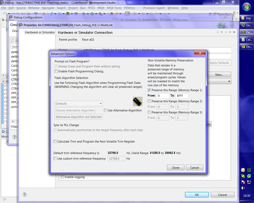

Hi all,
I'm using CW 10.2, MQX 3.8.1 and Kinetis K60 target.
I placed my code at address 0xC000 but i am not able to debug it.
When i try to debug my code, CW makes code downloading accurately but entry point is not my main but 0xfffffffe.
This is my memory layout in linker file:
MEMORY
   vectorrom   (RX): ORIGIN = 0x0000C000, LENGTH = 0x00000400
   cfmprotrom  (R): ORIGIN = 0x0000C400, LENGTH = 0x00000020
   rom         (RX): ORIGIN = 0x0000C420, LENGTH = 0x00073BE0  # Code + Const data
   ram         (RW): ORIGIN = 0x1FFF0000,LENGTH =  0x00020000  # SRAM - RW data
   # kernel space starts after RAM variables (Location of MQX Kernel data + MQX heap)
   end_of_kd   (RW): ORIGIN = 0x2000FFF0, LENGTH = 0x00000000
   # Boot stack reused by MQX Kernel data
   bstack      (RW): ORIGIN = 0x2000FA00, LENGTH = 0x00000200  # Boot stack
   end_bstack  (RW): ORIGIN = 0x2000FBFF, LENGTH = 0x00000000
   # extdatavar  (RW): ORIGIN = 0x60000000, LENGTH = 0x0005C000  # external SRAM - RW data
   exttpnvar   (RW): ORIGIN = 0x6005C000, LENGTH = 0x00004000  # external SRAM - RW data
   extramdisk  (RW): ORIGIN = 0x60060000, LENGTH = 0x00020000  # external SRAM - RW data
Can you help me?

Teckna
Contributor V
Many Thanks Norm :smileywink:,
my problem was erase of bootloader loading application placed at 0xC000.
In Debug configuration it's possible to preserve a Memory range when you make a memory programming as indicated in next screenshot.
