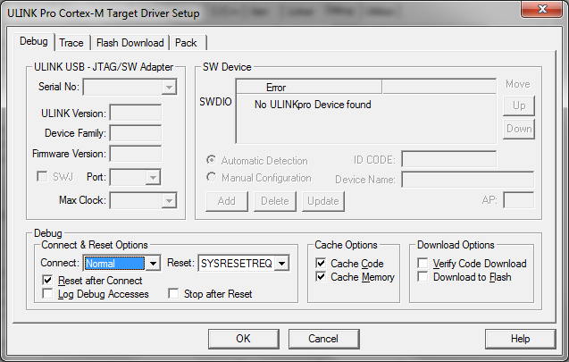

I am using  keil uvision V5.28.0.0.I was compiled example code. OK.But i am unable to see the printf messages in Debug(printview).These are the settings in project.
I am trying in LPC54608 NXP board and using ULINKpro debugger.
please help in this regard.

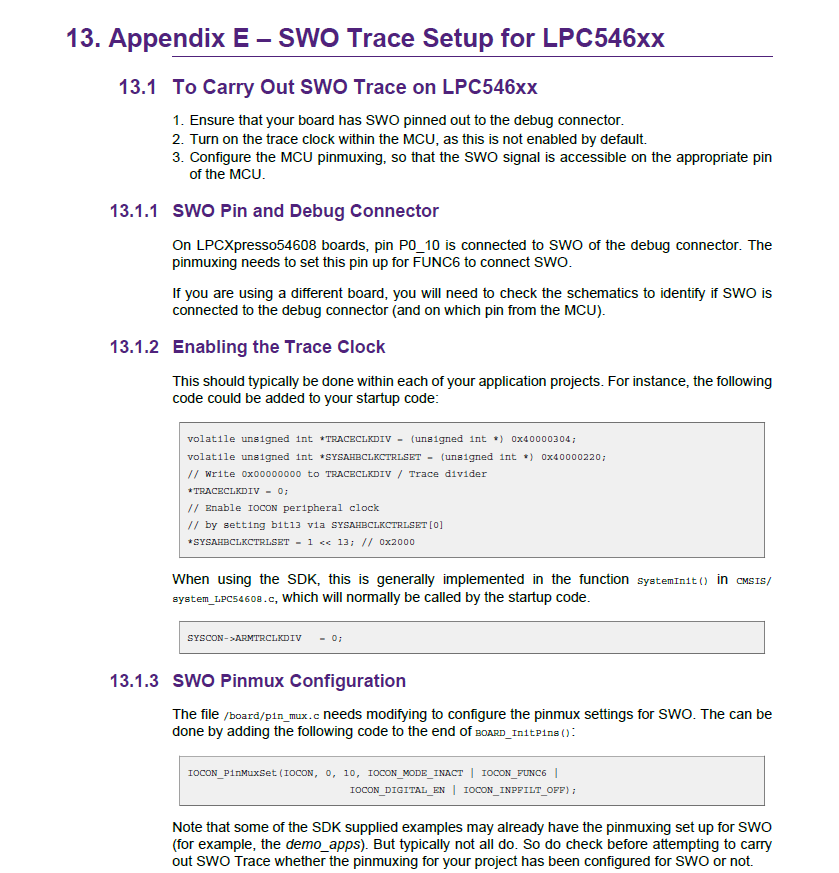

Hi dram,
Please check these key point.
This is from MCUXpresso document. I think it is also fit for KEIL too.
Jing
