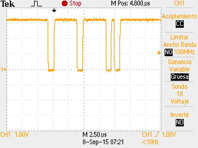

Good afternoon:
I’m triying to use the D4D library on a custom pcb using the MK53DN512CMD10 microcontroller but I have some troubles. At the beginning I used the TWRK53N512 and I didn’t have troubles starting the LCD (NHD-1.8-128160EF).   The custom pcb is connected as shown on the table.

I already changed this pin configurations on the d4dlcdhw_gpio8080_8b_cfg.h file as follow:

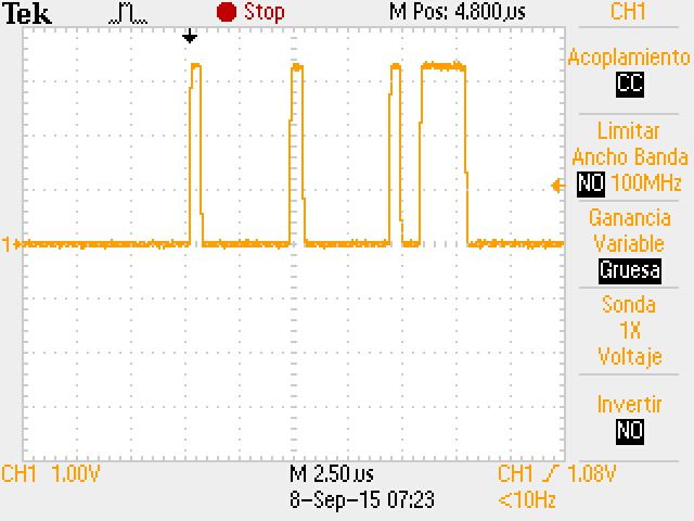

And with this configuration doesn’t appear anything on the LCD. I verified every signal, and I noticed that on pin 6(D/C-Data/Command selection) the signal is like this
And the signal of the tower, where the code works, is like this
I think the signal in this pin is the problem, cause the other signals are the same in both boards.
Did I miss change something in the code? What could be a solution for this trouble?
I will apreciate a lot your help !!!!!

LuisCasado
If the problem is the polarity of DC signal, you should change:
#define D4DLCD_ASSERT_DC WRITE_PIN(C,11,0);
#define D4DLCD_DEASSERT_DC WRITE_PIN(C,11,1);
Luis

joséflores
Hi Luis,
Thanks for your answer. I changed the configuration as you told me, but unfortunately I still have the problem. Do you have any other idea to try to solve this problem?

EarlOrlando
Senior Contributor II
Hello José,
If the configuration is the same in both projects I think that there is a hardware problem, could you please share your schematic?
