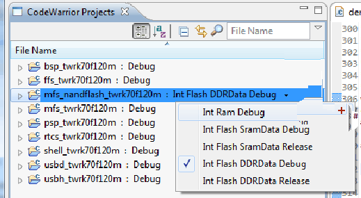

DavidS
Hi Jessica,
Please check what target you are building with.
Many of the default MQX applications builds use the "Int RAM Debug" target which may fit into the available onchip RAM to run but then you have a limited heap space.
Using the other targets has the program( .code) in flash and the internal SRAM or DRAM used for the .data/.bss space.
Please try using one of the other targets.
David
