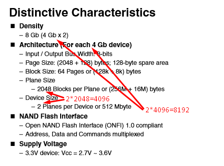

I’m are using MQX 4.1and a K20FX512VLQ12 connected to a Spansion S34ML08G2 NAND flash memory chip.  Calls to IO_IOCTL_FREE_SPACE returns half the
memory size, 512K instead of 1MB.
I have updated the NANDFLASH_INFO_STRUCT to reflect the Spansion memory characteristics (page size, block size, etc…), updated
“wTotalInternalDice” in NFCNandMedia::initChipParam to show 2 dies on the chip.  I’m sure I’ve missed a value that needs to be updated, but I’m not sure what it is.
Has anyone had experience setting up the BSP / FFS using a NAND memory chip that has two dies?
I’m using CodeWarrior 10.6 with MQX 4.1
Thank you.

Hi Randall,
Could you please share here your NANDFLASH_INFO_STRUCT?
According my expectation, it should be:
/* S34ML08G2 organization */
#define S34ML08G2_PHYSICAL_PAGE_SIZE      2048
#define S34ML08G2_SPARE_AREA_SIZE        128
#define S34ML08G2_BLOCK_SIZE              131072 /* 128kB */
#define S34ML08G2_NUM_BLOCKS              8192  /*4096 for each 4 Gb device*/
#define S34ML08G2_WIDTH                  8
NANDFLASH_INFO_STRUCT _ S34ML08G2_organization_8bit[] =  {
  S34ML08G2_PHYSICAL_PAGE_SIZE,
  S34ML08G2_SPARE_AREA_SIZE,
  S34ML08G2_BLOCK_SIZE,
  S34ML08G2_NUM_BLOCKS,
  S34ML08G2_WIDTH

randalljordan
Radeks,
Thank you for your reply. I must have misunderstood the structure setup, I have the number of blocks set to 4096, I was thinking that setting wTotalInternalDies to 2 would take care of the total number of blocks. I’ll make the change and post the results.
I’ve attached the NANDFLASH_INFO_STRUCT (with the total blocks changed to 8192) in case there are any other mistakes I’ve made.
Again, thanks for your help.
-Randy

Hi Randall,
You are welcome.
You are right,
I spend several minutes until my calculations returns 8192 blocks. I must agree that description of memory structure in MT29F2G16 datasheet is slightly better.
I hope it helps you.

randalljordan
RadekS,
Changing the block size to 8192 increases the memory size to 518MB. Is there anything else you can think of that I missed?
Randy
