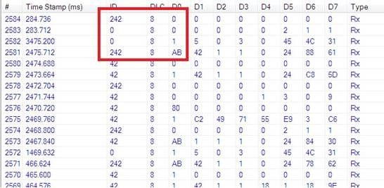

Dear Sol,
We have sniffed the CAN packets using CAN analyzer and observed that, the message identifier changed to 0(expected is 242) , which is unexpected.
Here transmitter is a device with K10(K20 BSP) controller and receiver is a K60 device. Seems the issue with the CAN driver or micro controller. Is there any workaround to fix this issue.?
