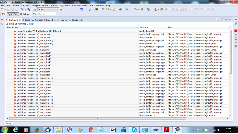

My customer is developing a product in which he writes and reads data into / from a NAND Flash, like the one we see in TWR-K70. The project has been tested and validated on this kit. The MCU uses is K70, the IDE is CodeWarrior v. 10.6.4 and MQX 4.2.
We got a lot of build errors related to mutex functions (see screenshot of them bellow) in several files from FFS library. After some analysis, we found that the root of those errors was a call to "_io_nandflash_wl_install" function in "Main_task". When we comment this function call, all those errors disappear.
But we really can't understand the reason for that, because FFS library is included in the project as well as its path in Properties. We also tried to include "nandflash_wl_ffs.h" file where this function is declared, but it doesn't produce any result.

Hi Marco :
I  checked your project settings, there is a linker order issue in your project settings, you can move down the  " _arm_start.o"  and " _arm_end.o" to the end of this list, as the below picture shows. I have tried it, it works

Hello, Daniel
Sorry for the late response.
I tried your tips and it is working now.
I could never imagine this would be the cause of the problem.
