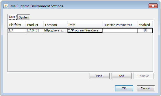

Clone Wizard does launch on my Win7 64-bit PC for any version of MQX4.0 or 4.1.
I get the following error:
Here is he version of Java I am running:
4,674 Views
bonzo
David,
I installed the 32-bit version of Java, and now it appears to work.
Brad
4,674 Views
DavidS
Hi Brad,
Very weird.  The default Java on my Windows 7 64-bit was Java 32-bit.  I downloaded and installed Java 64-bit and it now is the default Java engine and it works with my BSPCloningWizard.
You might try adding the path to the javaw into your Environmental variable PATH to see if that help.
Otherwise I can only suggest un-installing both Java and MQX, reboot and re-install to see if it fixes the path issue.
Sorry I cannot reproduce the issue.
David

bonzo
David,
Brad
