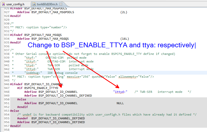

Bye the way I tried to use TWR-K60D100M bsp as my base bsp but I am having strange issue: printed messages are not printed on the console even though I enabled uart0 and choos ttya as default IO channel. this works when we take  TWRK60N512  as base bsp. You might help us to quickly solve the issue.

Hi Mehmet,
WRT the TWR-K60D100M, I have that and have successfully used the serial ports ttyd and ttyf but not ttya since it is not directly accessible on the tower kit.
Please check the following:
In user_config.h  set #define BSPCFG_ENABLE_TTYA 1   //DES default is 0
For the other BSPCFG_ENABLE_TTYx devices if you are not going to use them set to "0".
In twrk60d100m.h:

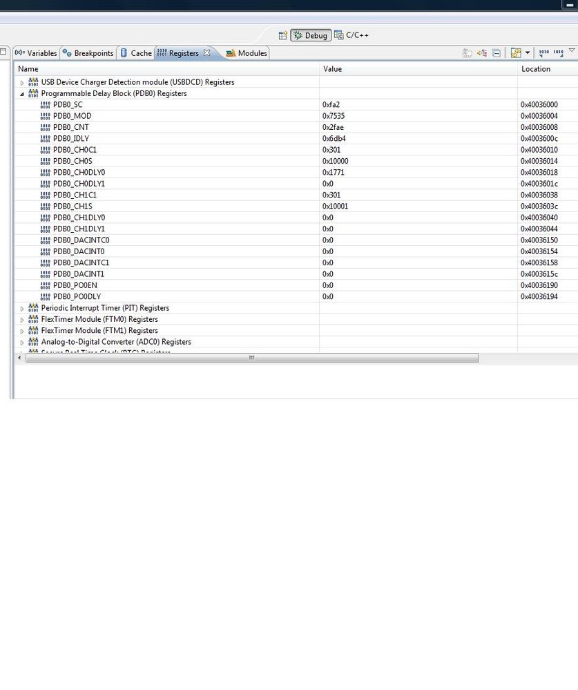

I have been working on the issue I have come to the conclusion of adc stops after PDB sequencing error occurs.
"Sequence error detected on PDB channel's corresponding pre-trigger. ADCn block can be triggered
for a conversion by one pre-trigger from PDB channel n. When one conversion, which is triggered by
one of the pre-triggers from PDB channel n, is in progress, new trigger from PDB channel's
corresponding pre-trigger m cannot be accepted by ADCn, and ERR[m] is set. Writing 0’s to clear the
sequence error flags."
Documentation doesn't tell what will happen if sequencing error occurs. I don't understand why it stops I would expect the ADC to continueu its operation after next trigger arrives.
I hope you can clear what documentation does not .
Mehmet

DavidS
Hi Mehet,
Please check the following setting:
Sequence error is typically happened because the delay m is set too short and the pre-trigger m asserts before the previous triggered ADC conversion is completed.
David
