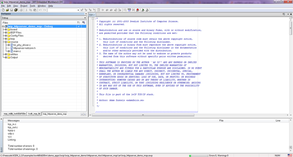

Hello Fred,
Sorry for the delay, could you please try using KSDK 1.2. I built this example without issues.
Go to C:\Freescale\KSDK_1.2.0\examples\twrk60d100m\demo_apps\lwip\lwip_httpserver_demo\httpserver_rtos\httpserver_mqx\iar
Drag lwip_httpserver_demo_mqx.eww to IAR
Build mqx_twrk60d100m
Build mqx_stdlib_twrk60d100m
Build ksdk_mqx_lib
Build lwip_httpserver_demo_mqx
