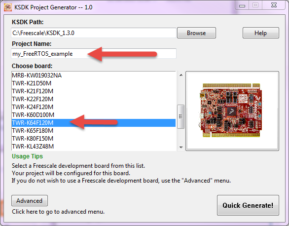

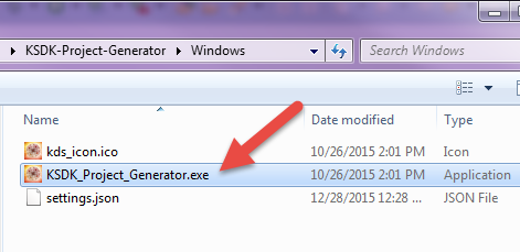

1. Launch the Project Generator executable.
2. Introduce the Project Name and choose the board used. For this example it is used the TWR-K64F120M.

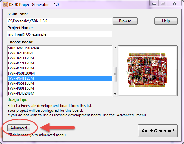

3. In order to generate a FreeRTOS project, click on the "Advanced" button.
4. Choose the operating system, in this case FreeRTOS, the IDE KDS and select Generate standalone project.
5. After that, click on "Advanced Generate" button to create the project.

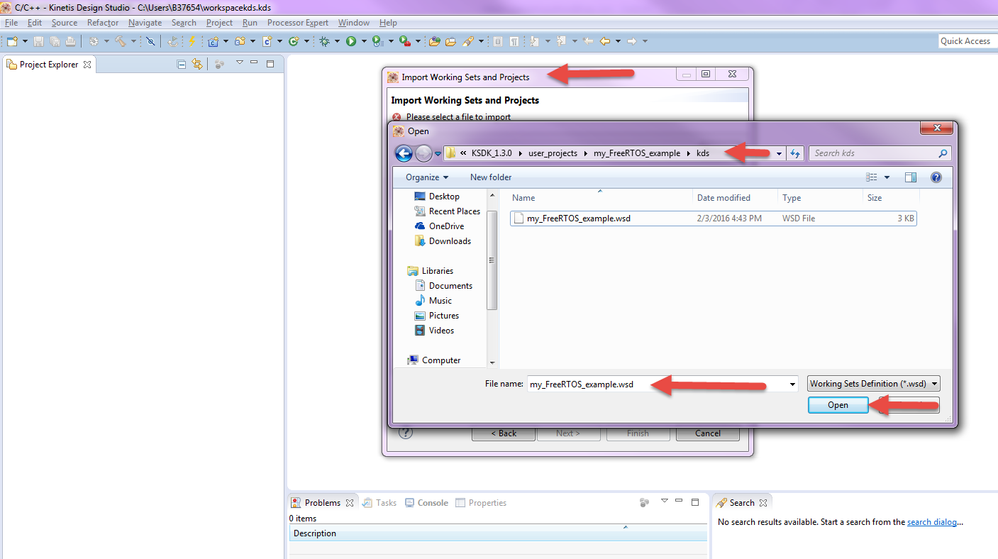

Open the project in KDS
Every application/example created using the KSDK Project Generator tool has one associated working set description file which includes the path to the example project file and the dependent RTOS library project file.
Simply import that file into KDS working space.
At this point you should be able to build the library and the project created.

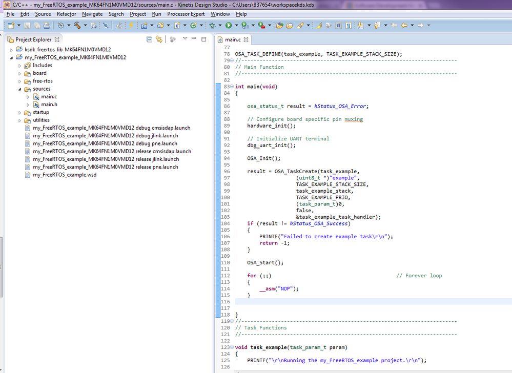

Developing a FreeRTOS with KSDK application
Operating System Abstraction layer (OSA) provides a common set of services for drivers and applications so that they can work with or without the operating system.
OSA provides these services: task management, semaphore, mutex, event, message queue, memory allocator, critical part, and time functions.
An easy method to create a task is using  the OSA_TASK_DEFINE macro and the function OSA_TaskCreate(). The macro OSA_TASK_DEFINE declares a task handler and task stack statically. The function OSA_TaskCreate() creates task base-on the resources declared by OSA_TASK_DEFINE.

The project created using the Project Generator tool creates one  task (task_example) implementing OSA.

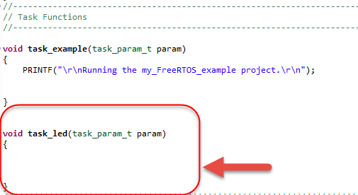

1. Add a new task named task_led. Add also a macro for OSA_TASK_DEFINE, the priority of the task and the prototype.
To initialize and start RTOSes, OSA uses abstract functions OSA_Init() and OSA_Start(). Call OSA_Init() after calling hardware_init().
2. Create the empty body of task_led
