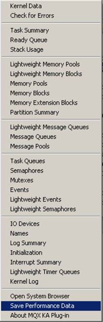

The MQX pull down menu is as below picture shows.

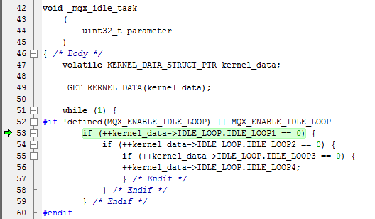

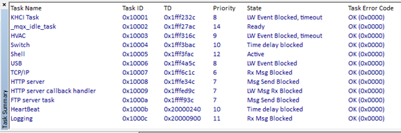

The task summary window shows all the tasks in the system, the task name , task id , task state, priority and Task error code. The idle task is also listed since this is still treated by MQX  as a task, and can be helpful to know what’s happening with it.

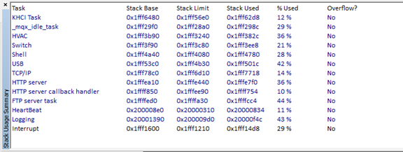

The stack usage window shows what percentage that allocated for a task interrupt have been used so far. This is a high watermark not the amount of the stack currently been used. If more than allocated stack is being used as some point, then you will see an over flow has been indicated at last column. Also for reference, the address for both the base for up and down are  shown.

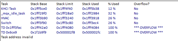

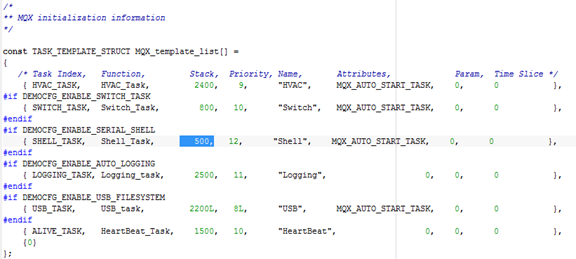

In order to gain experience using the Task Aware Debugging (TAD) feature and to learn how it can be used to debug an application, I created a stack overflow in the shell task in web_hvac demo by reducing the task stack size from 2400 to 500.
If I now run the application, we can see the application run into idle task quickly.

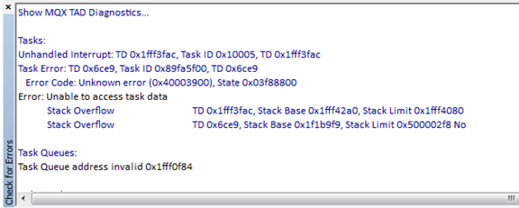

Opening up the stack usage window, we see that indeed an overflow was detected.

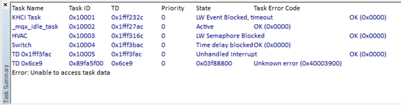

And that the stack information for the Shell task has been corrupted as a result.  The task summary window also has the corrupted information for the shell task.

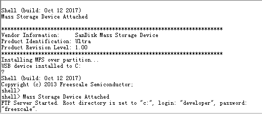

If you look closely, the listed tasks are short than before, and if you compare the list of tasks what you expected to be there. You noticed to shell task has completed disappear. But when we look at the console, we see that it clearly started.
So where did it go? The stack overrun is a good clue. But also recommend scanning check for errors window.
By reviewing the task summary, stack usage and errors windows, and doing a sanity check again the states values that expecting   can be very helpful ,make sure all the tasks are there. Check for error codes, and look for stack issues. To debug an application, the following steps should be follow:
