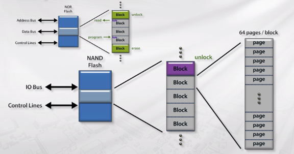

There are two main types of flash memory, the first being nor flash , and the second being nand. For an interface point of view, the main difference is how the data is accessed. Nor flash is a full address and data  bus, similar to random devices, and nand devices is using io bus with commands , address and data being multiplexed to share the same bus. It is greatly reduces the number of pins to require connectivity in devices , But for software and data access perspective , there are more significant differences between the two types of memory.
At the core, each bit is storing using different tech knowledge. With nor flash , the memory region is divided by equal size units called blocks.  The size of each block in today’s technology ranges from roughly 32k bytes to 128 kbytes, but this is  totally dependent on the devices select and over the years this is changed.  The internal circuitry of nor flash allows each byte of the device can be individually addressable in the same way that you can address bytes stored in ram, or in an EEPROM and this is why a full bus is used with nor flash. However this only applies for reading a byte or programming an individual byte, the racing skimming must be done at the block level,  so unlock a  race state requires the entire block to be affected.
Nand flash , however, has being purposely architected differently in order to increase the storage density.  It too has a memory region divided in equal size of  blocks, but each of these blocks are further broken down into samll regions that are called pages, the page is typically 2k bytes in size and a block often has 64 pages, so 128 kbytes , to the lead data you still be working at the block level, but if you want to read and program part of flash, this is done page by page.
However storing or retrieving data one page at a time is actually an advantage for many applications. Since you are often working with a large files such as  a phone, a song or an app.  So this is can be more efficient. The main draw back then of not being able to access bytes  individually is that nand flash can’t  be used to store a program code that you want to be executed in place. Since a CPU needs to read a single instruction, unless your CPU can specifically support this arrangement. There are a couple of downsize that the nand flash you maybe aware of however,  the first is in getting bit errors when you reading a page,  this is may not be a disater for musical file but obviously not acceptable for a data file or a backup for your image.
To compensate for this , each page of flash has two sections,  the first is where your data is stored and the second is a smaller section is where error correction code is stored. There are differenct algorithm used to detect and correct for errors but the ideal is the data stored in ecc is used by the algorithm to detect errors  in the data,  and in some cases  correct an error in the data  field.  There is a limit to how much corruption can be detected, but minor errors such as a single bit error are dealt with regular basis without the application ever knowing it occurred.
The second issue with nand to be aware of that it is more prone to developing a faulty bit. And this is caused an entire block to be declared as being bad, in fact even a new flash device will have a small percentage of blocks bad and over time some of the active blocks can be come bad. Circuitry in the flash device detects the block’s bad during erase or progam cycle and a bad block manager keeps track of this . Blocks of bad are automatically remapped, and since this happens behind,  the interface of software  doen’t know the difference.
So to summarize the key differences between nor and nand, we saw you have to access data in pages with nand which is randly access in bytes . and there are differences in access time to erase, write and read from flash. The capacity  the flash  device contiues to rise for writes that is a steady rate,  but currently the largest nand devices have 10 times capacity of largest nor devices. And in terms of issues don’t impact the application code, we saw the nand flash requries bad block management  and error correction codes to deal with failure rate that experiences, the pin count is higher in nor given a type of interfaces has, which couple of with different capacity makes it more expencsive. And depending on how you using memory you maybe concered about the expected life cycle  of a chosen device .

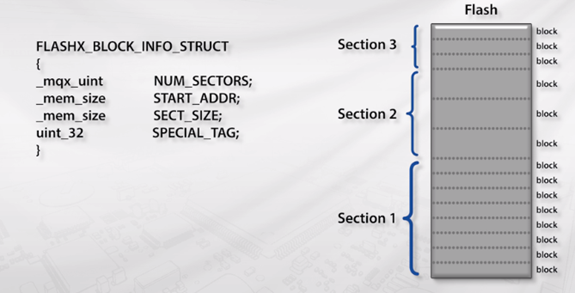

To understand flashx driver how it works , you need to farmilar with some key data structures that it uses. The first one to cover is the block info structure which defines how the flash is organnized. Some flash has different size blocks inside of it or maybe there is gaps between addressing . So this is a way of define a flash infrastructure.
Your device will be represented by an array  or a block info structures,  one section for each section a  flash has continuous addressing  and all blocks  are in equal size.  The terminal is a bit  confusing here,  within each section of flash  there will be a number of blocks,  and the data structure   refers to is a  sector,   as mqx considers a sector to be the smallest eraseable units.
The next element of this structure is the starting address of this section which is followed by the size section. The final element is reserved for any special flags and currently not being used.
