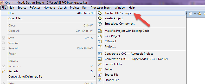

1. Open Kinetis Design Studio.
2. Go to 'File' menu and click on File->New->Kinetis SDK 2.x Project

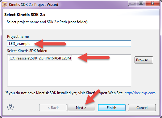

3. Select a project name and the Kinetis SDK folder then click 'Next'

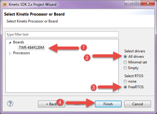

4. Select the processor or board to be used, in addition it is important to include all SDK drivers and add FreeRTOS to the project and click 'Finish'

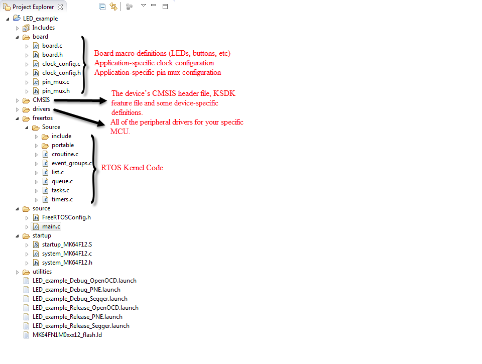

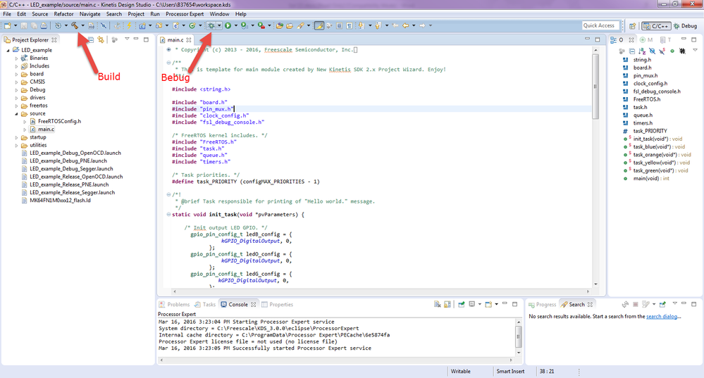

5. In the project created you can see the following folder structure:

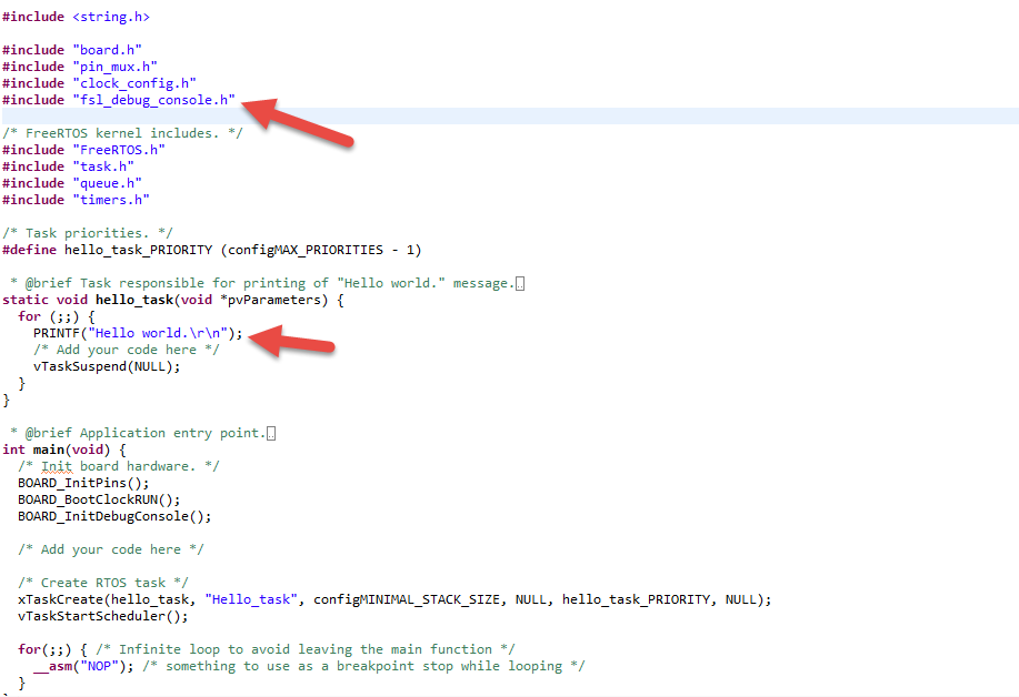

6. The main.c file is a template for main module created by new Kinetis SDK 2.0 Project Wizard, this contains a task responsible of printing "Hello world." message.
7. If you want to build and debug this example uncomment the next lines:
#include "fsl_debug_console.h"
and
PRINTF("Hello world.\r\n");
8. Build and debug.

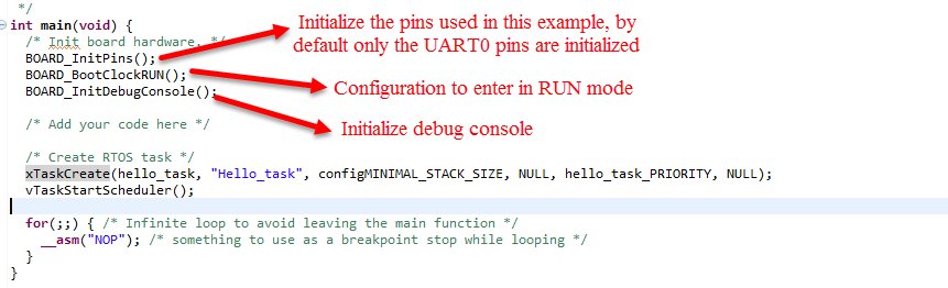

After a new project is created, in the main function the following routines are called in order to initialize the board hardware:
BOARD_InitPins();
BOARD_BootClockRUN();
BOARD_InitDebugConsole();
By default only the UART0 is initialized in order to use it as debug console.

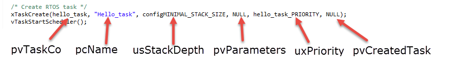

Also in main it is created a task (hello_task) using xTaskCreate () function.
xTaskCreate () creates a new task and adds it to the list of tasks that are ready to run; it contains the following parameters:
  • pvTaskCode. Pointer to the task entry function. Tasks must be implemented to never return.
  • pcName. A descriptive name for the task. This is mainly used to ease debugging. Max length defined by configMAX_TASK_NAME_LEN.
  • usStackDepth. The size of the task stack specified as the number of variables the stack can hold - not the number of bytes. For example, if the stack is 16 bits wide and usStackDepth is defined as 100, 200 bytes will be allocated for stack storage. The stack depth multiplied by the stack width must not exceed the maximum value that can be contained in a variable of type size_t.
  • pvParameters. Pointer that will be used as the parameter for the task being created.
  • uxPriority. The priority at which the task should run.
  • pvCreatedTask. Used to pass back a handle by which the created task can be referenced.

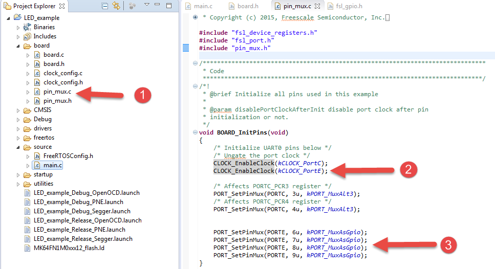

To initialize the GPIO, enable the port clock, define a pin configuration, either input or output, in the pin_mux.c file, as is described in the below steps:
  1. Open the pin_mux.c file.
   2. Enable the port clock.
     CLOCK_EnableClock(kCLOCK_PortE);
   3. Configure these pins as GPIO signals.
      PORT_SetPinMux(PORTE, 6u, kPORT_MuxAsGpio);
    PORT_SetPinMux(PORTE, 7u, kPORT_MuxAsGpio);
    PORT_SetPinMux(PORTE, 8u, kPORT_MuxAsGpio);
    PORT_SetPinMux(PORTE, 9u, kPORT_MuxAsGpio);
