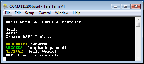

Successful completion of the example should show the following in the terminal window.
Figure 1: Example of successful execution.
NOTE: The demo uses the DSPI_DRV_EdmaMaster driver. Therefore, it is necessary to have a Kinetis device that supports this driver. The new source code was tested on FRDM-K64F. To successfully complete the DSPI eDMA loopback pins J2-8 and J2-10 need to be connected together on the FRDM-K64F.
