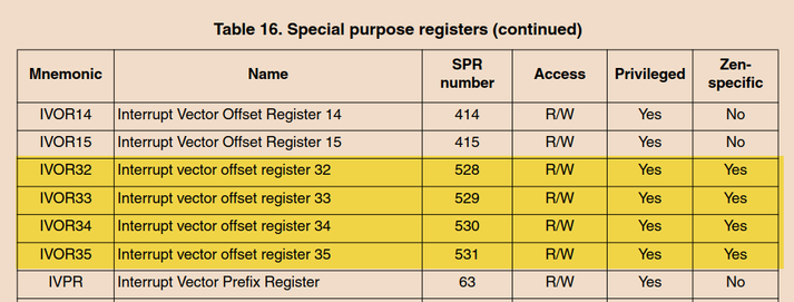

I’m trying to understand where IVOR16–IVOR63 (reserved / implementation-dependent) should be placed in the linker script for MPC5674F.
Book_EUMBook_EUM
MAP FileMAP File
from SDK generated files there are no vector defined for IVOR16-63 properly.
The e200z7 core reference manual lists IVOR0–15 as defined and IVOR16–63 as reserved or implementation-dependent. Should we still allocate space for IVOR16–63 in the vector table section?

davidtosenovjan
There are defined vectors 32-35 foe SPE/EFPU, so if application uses these engines, it should be define otherwise it is not necessary in principle.
RTOS may have specific requirement that is needed to keep.
