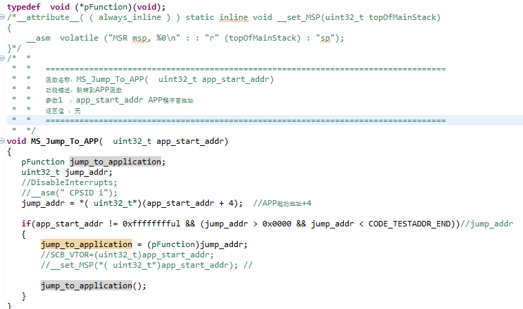

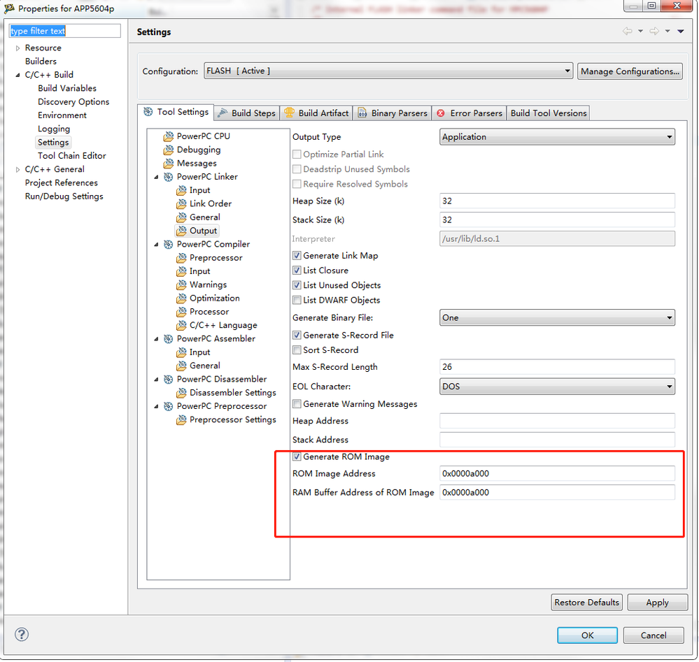

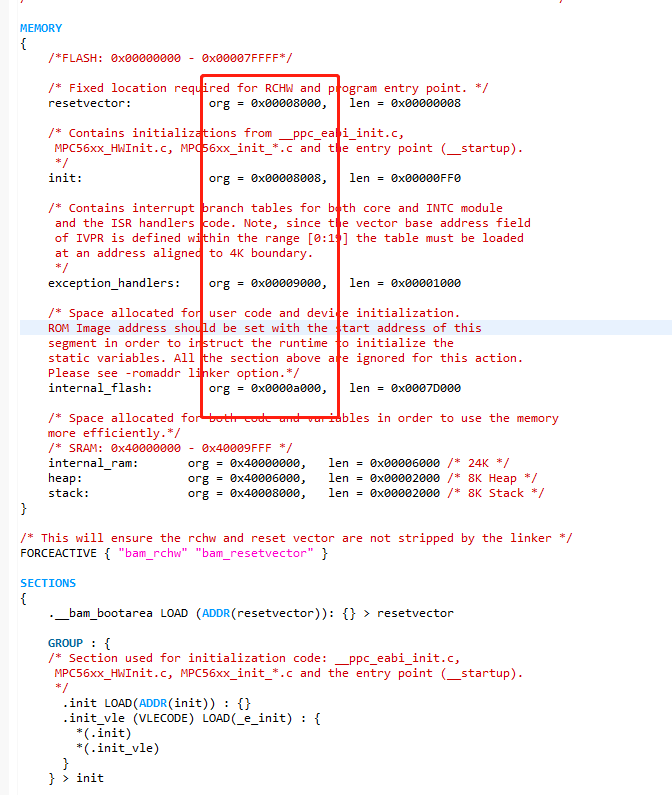

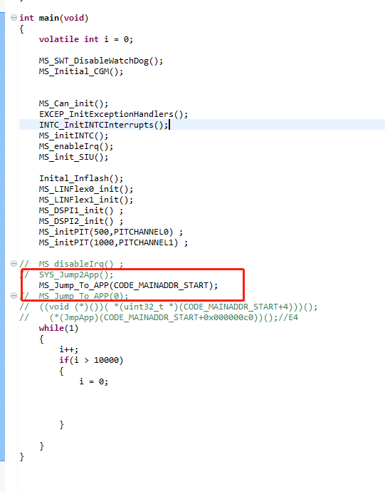

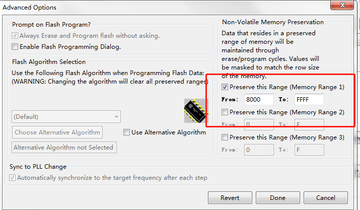

the boot program is next,CODE_MAINADDR_START= 0x00008000(the APP org address);the code warrior warns No source available for "0x00000004 (0x00000004)() ; if CODE_MAINADDR_START= 0x00(the boot org address),the boot program jump to the boot program circulately,and it work well in the boot.
the APP link file is next
when I download the APP(org address is 0x00008000) using the code warrior 10.6,the APP program is work well.but the boot jump to the APP ,the code warrior warns the “source available for "0x00000004 (0x00000004)()””。I really do not how to it and can not get the issue about the problem. please help me ,I  warry it a lot !
