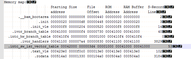

I have a question about using .lcf. I want to allocate my code into two flash blocks.
one is in Code Flash Sector 0(start addrees:0x00000000  end address:0x00007FFF), the other is in Code Flash Sector 6(start addrees:0x00040000  end address:0x0005FFFF). The first one is placed in text section, the second one is placed in internal_flash.
The updated .lcf file is shown below:
MEMORY
    resetvector:           org = 0x00000000,   len = 0x00000008
    init:           org = 0x00000020,   len = 0x00000FE0
    interrupts_flash:      org = 0x00041000,   len = 0x00001000
    internal_flash:        org = 0x00042000,   len = 0x0003E000
    internal_ram:          org = 0x40000000,   len = 0x00006600
    heap  :                org = 0x40006600,   len = 0x00000900
    stack :                org = 0x40007000,   len = 0x00001000

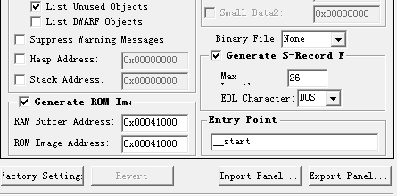

Then modify the rom image address as below:

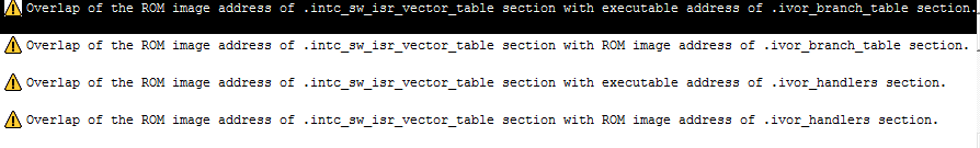

When I compile and link the code , warning message will be shown:
If I change the  ROM image address to 0x00042000 (equal to internal_flash address). There are no warning message.
In my understanding, the objects stored in flash should be code or constant data, so their virtual address should be equal to ROM address. They needn't copy operation. but actually the address are not the same.
Why? what's the relationship between ROM image address and memory allocation?

When "Generate ROM image" is checked then linker generates ROM (flash) block for global variables/objects that needs to be initialized during start-up. If not checked e.g. RAM target this initialization is done by debugger.
Now "ROM Image Address" determines where this block should be placed.
The address should match with start address of the  main flash block - which is usually internal_flash (0x00042000).
So the ROM image block is physically placed at the first free address available in this memory segment (so after all sections that are placed into internal_flash).
The memory map you posted probably refers to the previous case -Rom Image Address set  0x00041000.
Regarding RAM Buffer Address - It's recommended to keep the address the same as ROM Image Address.
It specifies the address in RAM that is to be used as a buffer for the flash image programmer. But this feature is not used by current run control devices.
RAM buffer is not created/used when the RAM address equals to the ROM address.
