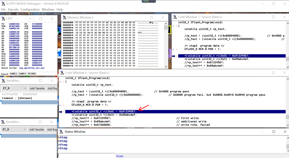

I run my firmware in SRAM, and tried to program data(16 bytes) to code flash:
when i write to location 0x0000_0010 or other CFlash area,  it works, and data be correctly burned in.
But when i tried to write to location 0x0000_0000 ,  it failed, my firmware will be locked.
Looking forward for your advice.
Many thx.
Hawk.

On address 0x0, there is usually stored RCHW, that's probably the reason.

I did more test, pls check the picture below.
My firmware will locked in IVOR6_Vector when i set data to location 0x0.
Erase seems to be the same, when i set 0xFFFFFFFF to location 0x0, it will  be locked, but if i set 0xFFFFFFFF to other location, eg. 0x10, B0F0 block can be erased.
Is  address (0x0) protected?
Do you have any other hints?
Thx again .
Hawk.

You should not have opened memory dump window (as it is read operation in fact, it may affect erase/programming sequence).
