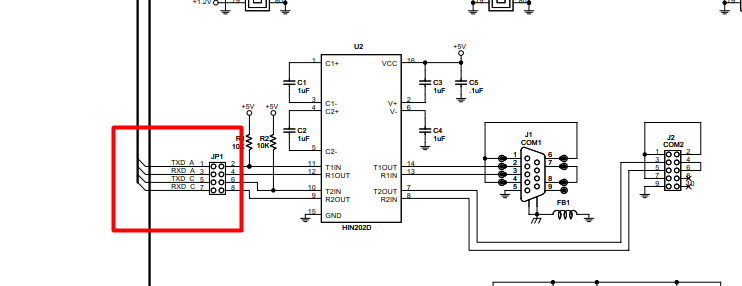

Hi, I am using mpc #5674f and I have to work with #uart peripheral in it. If I successfully initiate uart and be able to  receive data with it, but failed to transmit any bytes.
I am using the project atteched below. This is an example, and the link :Example XPC567XFKIT PinToggleStationery CW210
  • The problem is;
  • the data can be received but never be transmitted via uart. Nothing is displayed in the terminal window.

Hi, do you have plugged all jumpers on motherboard's header JP1?

jwsmarte
Thanks a lot!  I got it!
