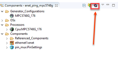

lukaszadrapa
Hi @tejo2one
I can see no problem on my side. What I did:
File -> New -> S32DS Project from Example
Then I selected mentioned enet_ping example for MPC5748G.
Now the key point - it is necessary to generate the code by this:
Or select in main menu: Project -> Generate Processor Expert Code.
Then you should be able to build the project.
