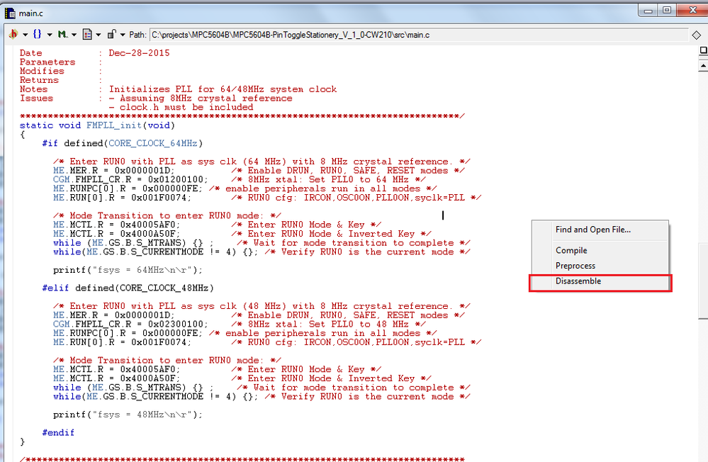

(1) codewarrior optimization options optimization code how to view the assembly language?
(2)  whether the project is recommended to use optimization options; (3) Some people think that codewarrior optimization options could introduce a bug so do not recommend Use, is it reasonable? (4) My project has entered a small batch test, 500 boards only a board appears such a situation, whether I need to cancel the optimization options. Is this necessary?

1) For assembly code, right click somewhere in C file and select Disassemble.
2) If you use higher optimization, your code will be smaller, but also it will be more difficult to debug it and compiling will be slower. There is a description under each optimization level, so you can read, what optimizations are done.
3) It is possible that high level optimization will create some bug in the code. Unfortunately any compiler is flawless.
4) In case your code does not work as expected with optimization, I recommend you set optimization off and do not use it (if it is possible).
