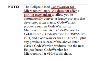

I use the cw 2.10 in windows 7, but it can not use in windows 10 ,so I need to upgrade version 11.1 in windows 10,but i do not  want to add by one of one source.I want to import project quickly.Please  help me ?

I haven;t tried it but there is guide for porting classic to eclipse:
https://www.nxp.com/docs/en/application-note/AN4727.pdf

There indeed used to be a CodeWarrior Classic project importer in CodeWarrior for MCU (eclipse based).
It was removed prom the product quite some time ago due to its limitations. Anyway If you'd like to try it you can download and install CodeWarrior v10.2 where it should be still available and try to migrate your project.
Anyway you can always create a dummy project in the latest version of CW for MCUs and copy your existing source files into new project, adjust the .h file paths, adjust the tools settings (see attached document) to match with your original project and copy linker file.  Such a project will already include debug configurations.
Hope it helps.
