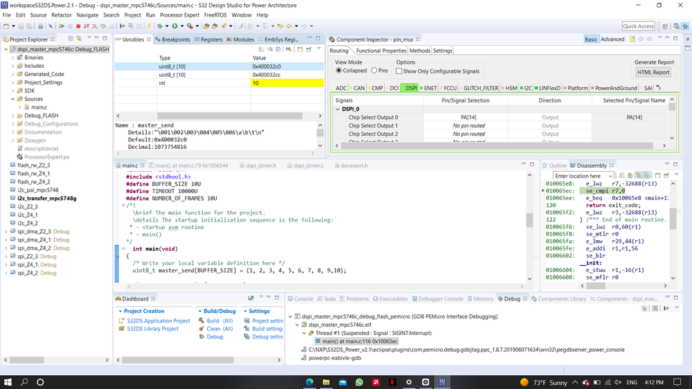

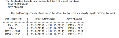

question 1: hi in this example (dspi_master_mpc5748g) it says to do the following pin configurations,
CS - SSJ3.8 - J14.15PA[14] - PK[12]
ClockJ3.6 - J13.12PA[15] - PK[11]
MOSI - MISOJ3.4 - J14.13PA[13] - PK[9]
MISO - MOSIJ3.2 - J14.3PA[12] - PK[10]
which pins are for master and which are for slave?
j3.8,j3.6,j3.4,j3.2 are for slave?

PetrS
are you using MPC5748g or MPC5746C? Seems you debug dspi_master_mpc5746c and shows pins config to this example. The dspi_master_mpc5748g configs DSPI_0 for master and SPI_0 for slave with below config
j3.8,j3.6,j3.4,j3.2 are for master pins
If you do no connection still you must see signal on j3.8,j3.6,j3.4 as master is sending  master_send buffer.
BR, Petr
