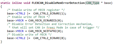

This is how the S32_DS access the registers. ( You can take a look at <driver name>_hw_access.h )
1) You can integrate your part to the S32DS project easily, including the MPC5748G.h header file.
2) MPC5748G.h already has the right memory mapping, you can check the locations of the registers by comparing them to the Reference Manual.
3) Also you can find this file in ProjectName/SDK/platform/devices/MPC5748G/include/MPC5748G.h
Best Regards
