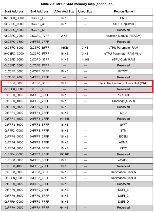

With 5644A, writing to CRC_CFG register causes a processor exception.
Using the definition of CRC in mpc5644a.h, at address 0xFFE68000
// For example...
CRC.CFG.B.POLY = 0;
Causes a processor exception.  What could be wrong?

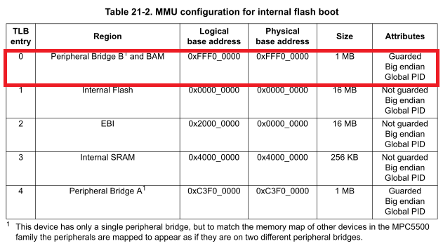

lukaszadrapa
the MMU is initialized by BAM code which resides in ROM memory. The same BAM code is used on more devices (not only MPC5644A) for compatibility reasons and also to avoid risk when changing the code. Unfortunately the default MMU settings do not cover CRC module because it is outside the MMU page covering Peripheral Bridge B.
The default MMU settings are:
But here you can see that CRC module is not covered by TLB entry 0:
So, it is necessary to adjust the MMU settings...
Lukas
