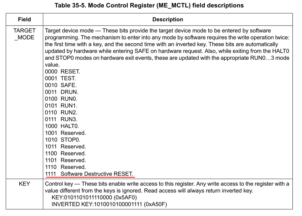

       I want to do a system reset at the end of my program on 5675K.And I write the code on the end of my programme.But the programme can not do a system reset by itself.So I only do a system reset on power.Why?
      The reset code is:
ME.MCTL.R = 0x00005AF0;/*复位*/
   ME.MCTL.R = 0x0000A50F;

If you want to do SW functional reset set:
0x00005AF0
0x0000A50F
for SW destructive reset set:
0xF0005AF0
0xF000A50F
Peter

petervlna
It should looks like;
ME.MCTL.R = 0xF0005AF0;
ME.MCTL.R = 0xF000A50F;
Peter

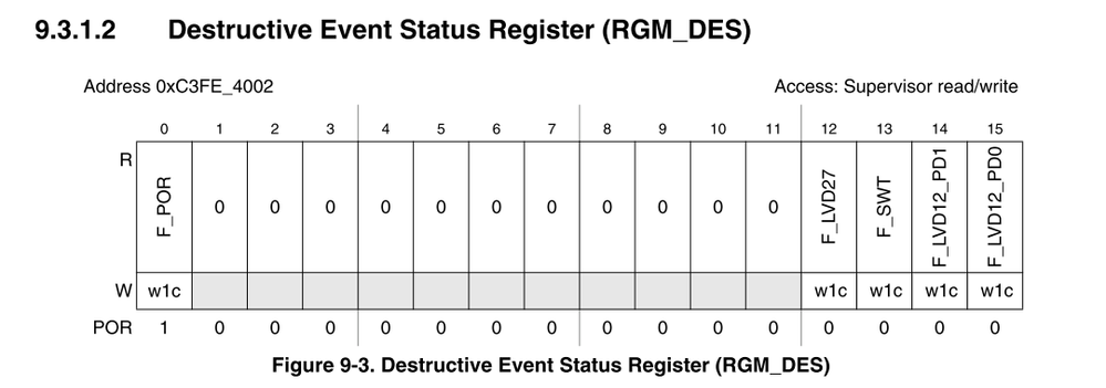

rehabmansour
Hi Peter ,
I need to do a SWT destructive reset for MPC5606B ,but I can't find this in the data sheet ,any alternative for this value for MPC5606B ??

petervlna
Your SWT can trigger destructive reset.
let in SW your SWT expire and you will get it.

rehabmansour
Hello Peter ,
Thanks for answering ,is there any other destructive resets that can be forced by software for MPC5606B ?
4,439 Views
petervlna
You can see all the destructive reset sources in DES register:
So SWT or Voltage violation. For example you can control external SBC with SW via SPI/CAN or so.
