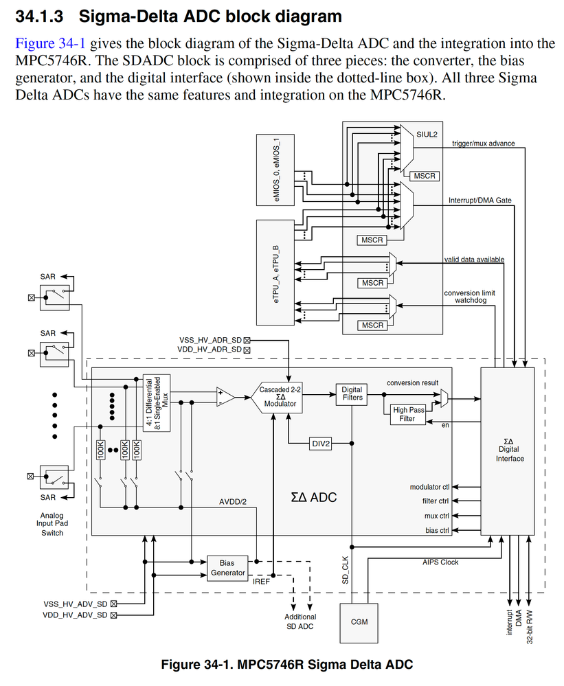

I am using the MPC5746R to collect data samples from the SDADC. Currently I am using a DMA transfer to remove conversion results from the data queue. If I wanted to employ a hardware trigger with the eMIOS, how would I go about doing so?
I have reviewed the 'Input Muxing' sheet in the 'IO_Signal_Description_and_Input_Multiplexing_Tables.xlsx', and found that the corresponding MSCR register is 970, for the Start Trigger mechanism. But I cannot find any mapping between this input and the eMIOS pins. I would like to also implement the DMA enable gate.

I have that configuration in place on the SDADC as well, but I am unaware how an eMIOS input is used as an input into the SIUL2.
In the top right corner of the block diagram, you see the mapping of the eMIOS into the SIUL2 as a start trigger and mux advance.
If I have configured the SDADC for a trigger input of type MSCR, and if I have configured the appropriate SIUL2 MSCR register, how do I configure the eMIOS pin as my hardware trigger input?

davidtosenovjan
You don't need to setup Scythian else. Mentioned MSCR register connects eMIOS internal channel to SDADC trigger.
If you want to use emios external pad, configure also following MSCR registers (considering PJ7 pad as an example):
2,404 次查看
davidtosenovjan
I think you have answered yourself. Then it is needed to choose TRIGSEL=0b11 in particular SDADC configuration register and that's it.
