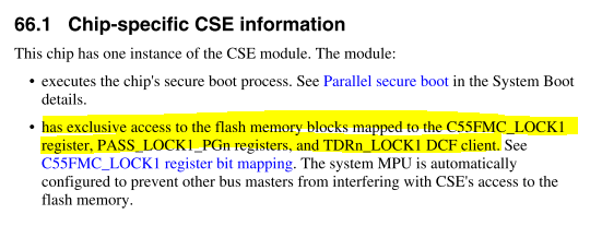

I wonder if I can use the CSE memory for non-CSE use, e.g. as general storage for MPC5777C
I have mapped the memory but I cannot write or read to it so I guess either it is not possible to use or I need to configure something first?

this is described in the reference manual:
So, the answer is no, the blocks can't be used as general storage.

Ok, thanks Lukas!
