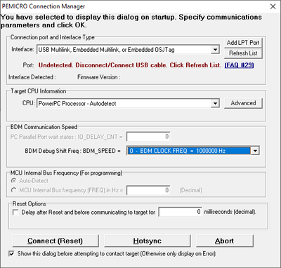

PetrS
script can disable MCU's internal watchdog, as shown above, but not any external one. Do you have any external watchdog on your system that can reset MCU externally?
For programming error, have you tried to decrease JTAG speed as well?
BR, Petr

jiachunyu
Hi PetrS
Thank you for your answer. Could you please tell me how to reduce the speed of JTAG?
5,438 Views
PetrS
it is set in connection manager that appears before downloading
BR, Petr
5,426 Views
jiachunyu
Hi PetrS
Thank you very much for your answer. Based on the method you provided, I have tried it on my software debugging interface. But when I connected to my debugger, "BDM Debug **bleep** Freq: BDM_SPEED="Unable to select and adjust speed. Is this a normal phenomenon? Due to my lack of permission to upload screenshots, I am unable to show you my debugging interface. Thank you!
