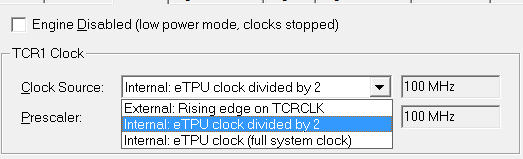

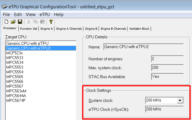

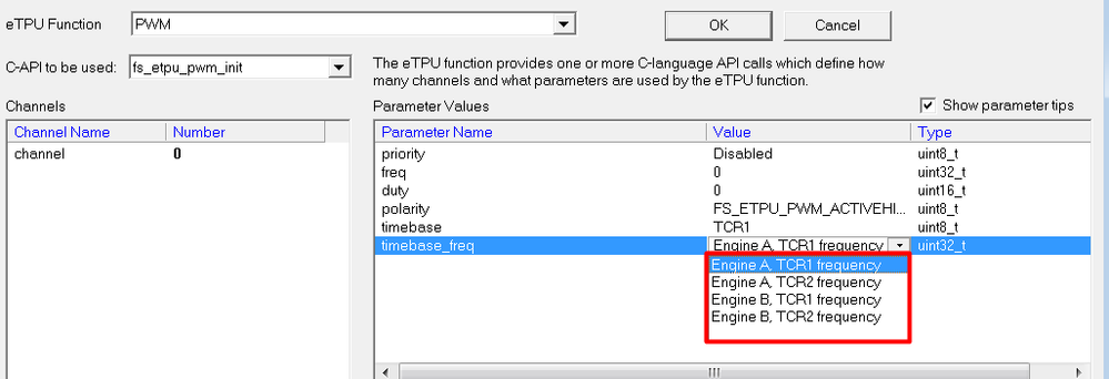

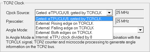

Hi, I will show you screenshot from GCT tool, event though you use it or not.
Time base frequency for PWM function can be chosen as Engine A/B, TCR1/2
These are derived from system clock by selected pre-dividers:
That's the time base for PWM function.
