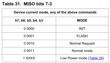

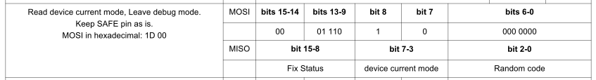

I found some time to play with the SBC chip. I tried this minimalist setup:
1. Send 0x1D00 (read device current mode). It returns 0x21FF.
2. Send 0x5A00 (enter normal mode)
3. Send 0x1D00 (read device current mode). It returns 0x2119 which means we entered normal mode.
4. Send 0x1300 as described in previous post. Random code is received.
5. Send (0x5280 OR inverted random code) to enter flash mode.
6. Send 0x1D00 (read device current mode). It returns 0x210B which means we entered flash mode.
Here are details about how to read current mode:

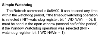

lukaszadrapa
either refresh the watchdog periodically (simply use command 0x5A00):
or enter Flash mode:
You can find command sequences in attached excel sheet.

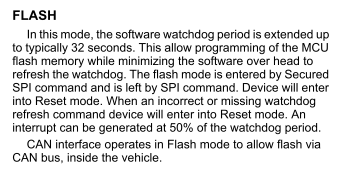

lukaszadrapa
the watchdog cannot be disabled in normal mode. You must either refresh the watchdog or you can use Flash mode to extend the timeout to 32s.

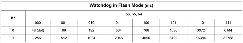

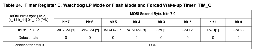

flash mode can be entered from normal mode in this way (copied from XLS file):
Then you can find that default timeout for flash mode is only 48ms:
So, it is necessary to re-initialize the timeout to its maximum:
That means you can use command 0x58 0xF0 to extend the timeout.
Lukas

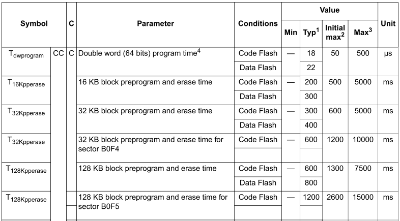

You wrote that the device is reset by SBC even if the watchdog is refreshed. How do you refresh the watchdog? Is the watchdog refreshed also during erase operation? As you can see in datasheet, erase operation can take a lot of time:
Do you use SSD flash drivers? Do you have your own drivers? It is necessary to find a way how to refresh the watchdog - if you use SSD drivers, it allows you to use callback function. If you have own drivers, update it, so the watchdog is refreshed in loop where you wait for end of operation.
