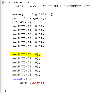

I did not checked your code.
I created for you simple example code for demonstration.
Peter

petervlna
I am using cut 2.0 and there is no issue with PCTLx for clock disabling.
Example:
I am using PC0 as a default power mode for peripherals. Where all my CANs are active.
Now I will dissable clock to CAN0.
For example set PCTL70 (CAN0) to ME_RUN_PC1.
Now perform mode transition to activate the new power profile RUN_PC0 where the CAN0 is excluded:
And the result is:
And really the CAN0 module clock is not present
Peter

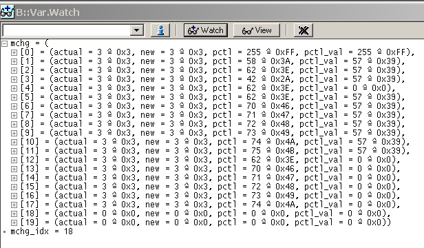

Finally, mode change tracelog looks like this:
where:
     - actual is current MCU run mode;
     - new is the mode to which we should switch;
     - pctl is PCTL register number if its value was changed before mode requesting mode switch;
     - pctl_val is the new value of PCTL above;
There is special case, where PCTL is not changed. This is shown by pctl = 0xFF, pctl_val = 0xFF
So, after 18 mode switches, on 19 my system refuses to switch its mode.

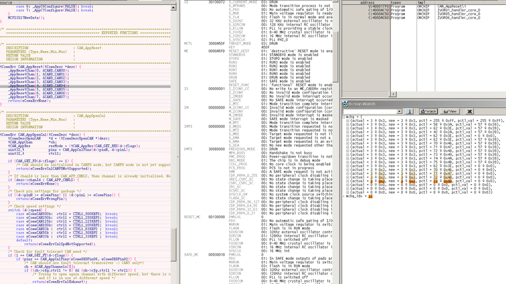

This is system state before start (only run to main, which includes some system initialization calls):
This is system state after CAN initialization (normal system run):

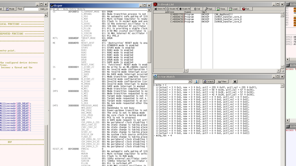

Then, I'm stopping the system and CAN0-3 are already stopped here:

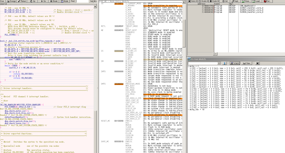

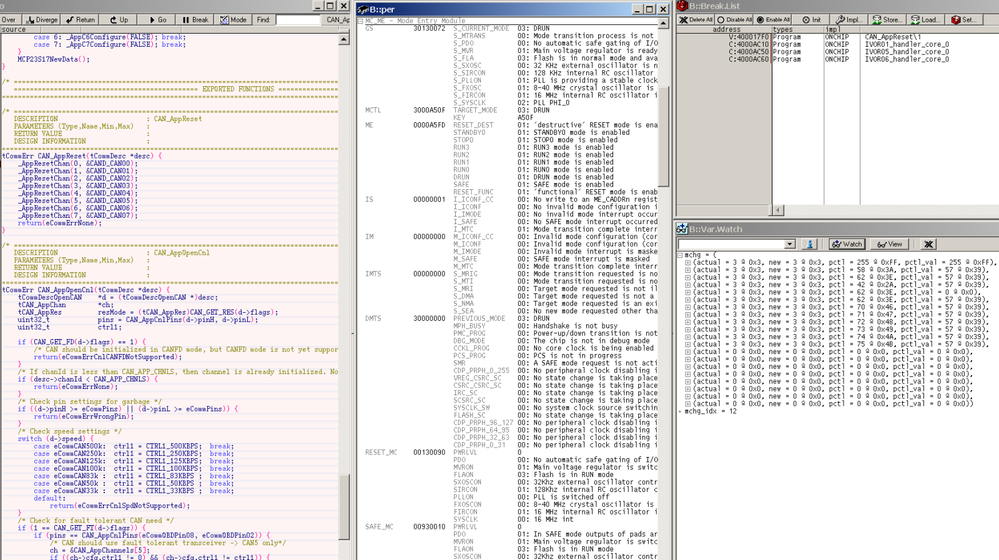

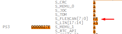

And this is system state one step before death (endless loop):

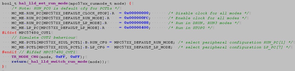

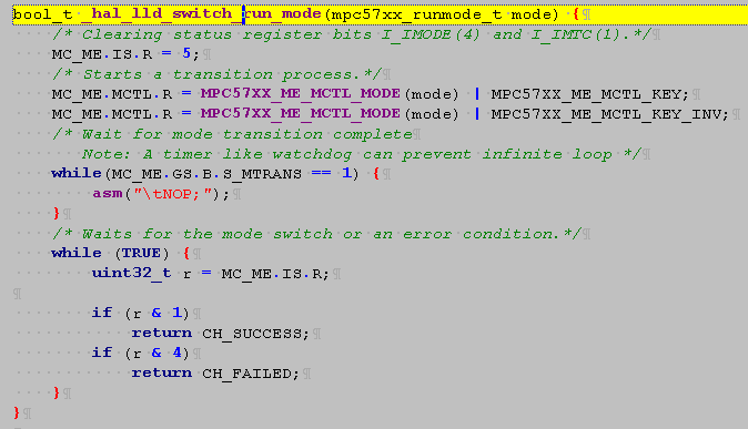

Mode switch is implemented as follows:
I hope now its more clear... You can see that I'm using three RUN_PC modes:
#define MPC57XX_DEFAULT_CLOCK_STOP  0
#define MPC57XX_DEFAULT_RUN_MODE    1
#define MPC57XX_DEFAULT_LP_MODE     7
When I execute described sequence on my system after setting of PCTL 74 I'm staying in the endless loop, checking S_MTRANS, which always stays 1, which is also seen in the last of big pictures above. System reports through CDP_PRPH_64_95 that "Clock disabling is pending for at least one peripheral" in this group (74). And this stays forever, because my watchdog is OFF for now, but watchdog reset is not real solution for me. If I remove call to clock stop of CAN4, rest of the CAN clocks are stopped fine. Problem is only with CAN4...
