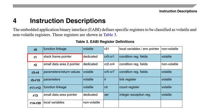

davidtosenovjan
According EABI convention, stack pointer is register R1:
