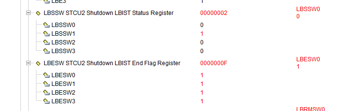

         we have found a strange situation, we test our source code on board with different versions of  MPC5744P, the result is different .
       our program can not working normal on our board (with chip mask IN15P), there always have three low blocks are failed .  But it can work on our old board (with chip mask IN65H) .

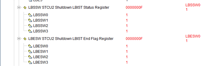

 the result is still like this on our B2 sample (chip mask IN15P):
but the results on our old sample - B1(chip mask IN65H):
why this is happen ? how can we fix it ?

3,011 Views
petervlna
For different cuts you need different MISR values.
For 1N15P use following:
STCU_LB0_MISREL
0x8CBF311B
STCU_LB1_MISREL
0xAC435093
STCU_LB2_MISREL
0x37732C00
STCU_LB3_MISREL
0xB4B9D509
STCU_LB0_MISREH
0xCD9077D8
STCU_LB1_MISREH
0x01599F6C
STCU_LB2_MISREH
0x23EA1647
STCU_LB3_MISREH
0xF3A1B551
We have created ticket for reference manual update.
Peter
