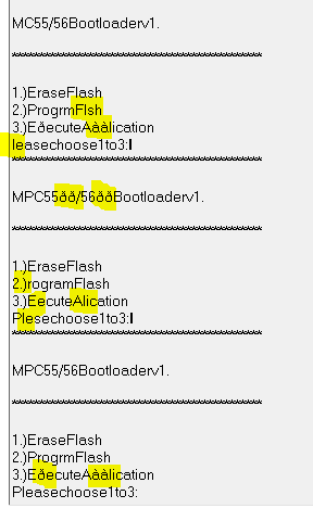

Ok thanks Lukas, this terminal works perfectly.
I tried the bootloader that you gave me and it works almost fine. In Codewarrior the baudrate for serial communication seems to be set to 115200baud
Or at this baud I had no communication. I used a logic analyzer and I found the effective baudrate is 80000 and now it works with Terminal. But I don't understand why the baudrate is less than 11500. Maybe my system clock is not set properly ? ( I don't change anything in the code and it supposed to be 80Mhz )
Also I have some random message error as you can see here ( I reset several time to show the random effect ) :
14,185 Views
lukaszadrapa
what is the crystal frequency on your board? It looks like you use 8MHz crystal, don't you? My application expects 12MHz crystal. There's note in InitSysclk function:
Sysclk = 80MHz running from PLL with 12 MHz crystal reference.
Change it to:
void initSysclk (void) {
     FMPLL.ESYNCR2.R = 0x00000002;
     FMPLL.ESYNCR1.R = 0xF0000028;
     while (FMPLL.SYNSR.B.LOCK != 1) {}; /* Wait for FMPLL to LOCK  */
     FMPLL.ESYNCR2.R = 0x00000001; /* Fsys =80Mhz */
Then it should work.

raphc63
Thanks it works well :smileywink: Yes I have a 8 Mhz crystal.

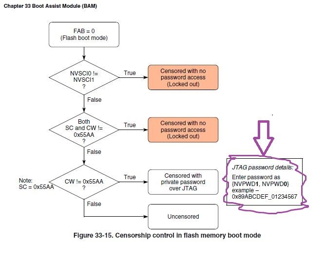

Hi Lukas,
In Flash boot mode, I want to uncensor the device. I got an idea, suggest whether I'm in right track or not?
1. Initially my user application will censor the device
         a.)    Erasing the shadow flash, programming the NVPWD registers with the right password and then programming the NCSCI registers.
2. Once the user application receives CAN id for flash boot mode with the right password, The user application will uncensor the device.(0x55AAxxxx,0x55AAxxxx)
         b.)    Erasing the shadow flash, programming the default NVPWD registers and then programming the NCSCI registers for uncensor (0x55AA55AA,0x55AA55AA).
3. The user application will delete the key and resets it to start the bootloading application.
Thanks and Regards,
Raju.

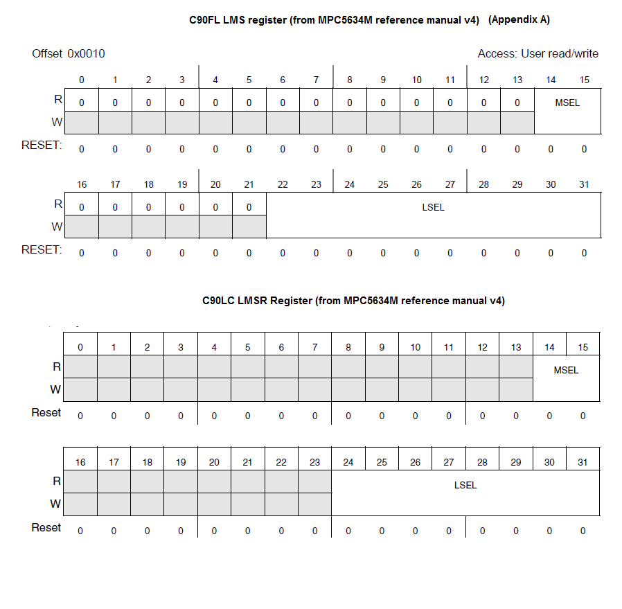

Hello Lukas,
Although this project seems to be written for MPC5634M (which contains the C90LC, right?), the SSD seems to be for the C90FL flash module. I've concluded this after I saw the EraseFlash function was trying to "enable" (I guess that means select-for-erase?) blocks which are signified by bits 22-23 of the LMSR.
unsigned char EraseFlash(void)
  shadowFlag = FALSE;
  /* Erase all blocks (except area occupied by bootloader) in low and mid addr space of flash array 0 */
  lowEnabledBlocks = 0x000003F8;
0x000003F8 -> bits 22->28 are set.
Screenshot from ref manual below:
Also, of course, there are some other differences between the C90FL and the C90LC.
Am I correct in this analysis?
I've downloaded the "MPC56xx C90LC Flash Standard Software Driver (REV 1.0.3)" from NXP software center but inside it the user manual states that the document is prepared for C90FL devices! Is the API for C90FL and C90LC really the same?!
If not, where can I find the SSD explicitly for C90LC?
14,187 Views
lukaszadrapa
API of SSD drivers is the same for C90LC and C90FL.
There's C90LC flash on MPC5634M. C90FL was used on first revisions (prototypes) of chip. Regarding appendix, there's note in Table A-2:
"MPC56xx C90LC Flash Standard Software Driver (REV 1.0.3)" - Yes, this one should be used.

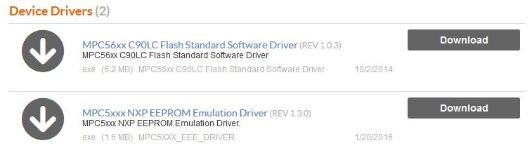

To find correct SSD drivers for a device, find the web page of device, for example:
MPC563xM|32-bit MCU|Powertrain|NXP
or
MPC564xL|32-bit MCU|Chassis-Safety|NXP
Then go to "Software & Tools" tab:
Then search for "Middleware - Device Drivers":
And here you can find the drivers for the device:
Lukas

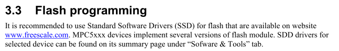

lukaszadrapa
It is mentioned in document which I attached to the bootloader:
When you download the drivers, the package always contains user guide and release notes, so I think it's enough.
Instead of comparing the c-arrays, it is much better way to download appropriate drivers and use them in your project.
Lukas
