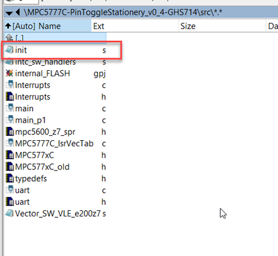

Kothe1995
init.s is not present in above example code
2,784 Views
davidtosenovjan
I can see it there.
