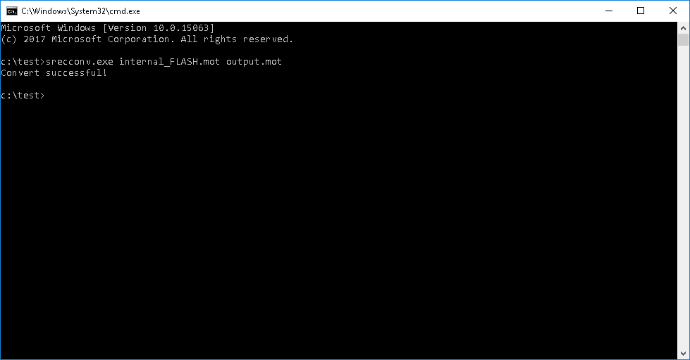

tony_huang
Hi,Lukas
      I cannot open SRECCONV.exe,  everytime I open it, it quickly open and quickly close less than 1s.
There is something wrong about the SRECCONV.exe.
      The file AN_qorriva_bootloader, it is not describe how to use pc terminal commnication  with hardware.
2,281 Views
lukaszadrapa
1. Run the srecconv in command line (cmd.exe) to see the result:
2. There are more details in:
https://www.nxp.com/docs/en/application-note/AN5319.pdf
https://www.nxp.com/docs/en/application-note-software/AN5319SW.zip
Lukas
