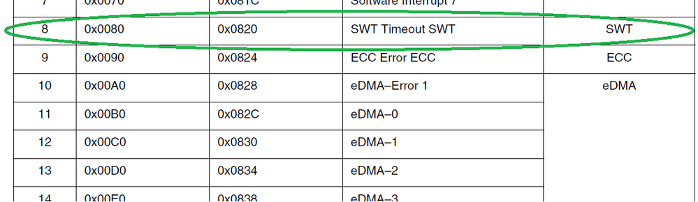

hbouch
Peter,
I just got why you were talking about IVOR4. In software vector mode all interrupts are routed to IVOR4...
I fixed my problem. I was expecting an IVOR12 interrupt which was never trigger... (I still don't understand why because it's the IVOR dedicated to SWT but anyways). The IVOR4 interrupt for SWT jumps to interrupt vector 8 (has in the image above). With the right interrupt vector configured, it works much better !
Thanks Peter for leading me on the IVOR4 ! It really helped.

petervlna
As SWT is periphery external to the core it must go trough IVOR4 (external interrupt).

hbouch
Hello Peter,
Thanks for your answer. IVOR4 is for external interrupt and not SWT interrupt. Am I right?
If I understand the E200z6 core reference manual, watchdog timeout triggers IVOR12.
Also, I belive the IF bit could be set without interruption the CPU as for other modules in the microcontroller if corresponding interrupt is not enabled. Shouldn't the bit TSR[WIS] = 0 be set if IF bit is set?
There is also interrupt vector 8 that is related to SWT:
I tried to set my isr on both interrupt but without success. And to answer your question, yes I configure the priority of the interrupt to the max value.
Any other idea?
