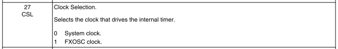

2. STM timer is clocked by 80MHZ in run mode, what will be the clock frequency and clock source in STBY mode, is it configurable?

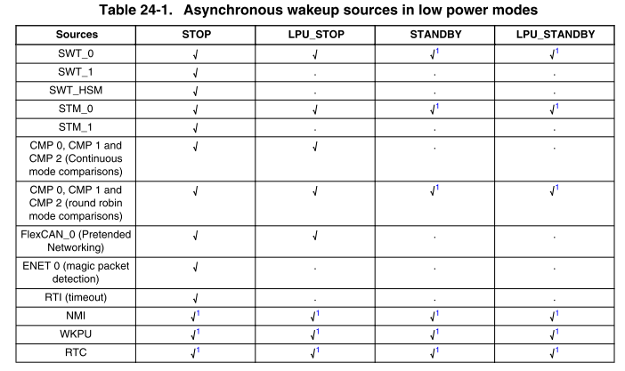

3. In case STM is not active in STBY which other timer can be used for period interrupt.

2. In standby, it is necessary to use FXOSC because system clock is not available.
3. STM_0 is active in standby.
